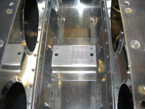

Section 21
Deburred and Primed F-1048F Facet Pump Bracket.
Pg. 21-19
Step 9: Clecoed the Facet Pump Bracket to the Bottom Skin and final drilled #30 the four common holes.
Step 10: Removed the bracket, final drilled #40 and countersunk the nutplate rivet holes. The riveted the nutplates to the bracket.
Step 11:Riveted the Facet Pump Bracket to the Bottom Skin.
Facet Pump Bracket
Facet Pump Bracket
