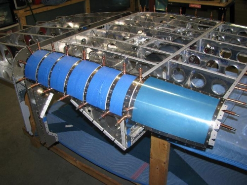

Step 2: Turned Fuselage upside-down and clecoed the Rt Corner Skins to the fuselage structure.
Step 3: Riveted the Corner Skins, except as indicated, to the fuselage structure.
Step 4: Repeated steps 2 & 3 for Lt side.
Step 5: Clecoed the F-1274-R Corner Skin to the fuselage structure.
Step 6: Riveted the F-1274-R Corner Skin to the fuselage structure.
Step 7: Repeated steps 5 and 6 for the left side.

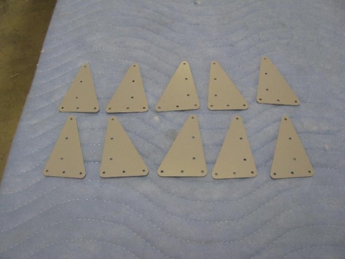

Step 9: Marked and Separated the F-1268A,B,C,D and E Doublers.

Deburred the F-1204Z Bottom Stiffeners and F-1268 Doublers
Corner Skins
Corner Skins

F-1268 Doublers
F-1268 Doublers
