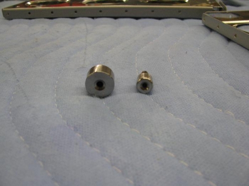

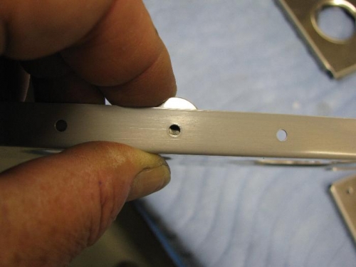

Ran into a problem dimpling the top flange of the center Step Ribs. My dimple die was too large to align with the holes in the flange (see photos). Ordered a small #30 dimple die from Avery Tools.
Holes misaligned
Holes misaligned
Sm & lg female dies
Sm & lg female dies
