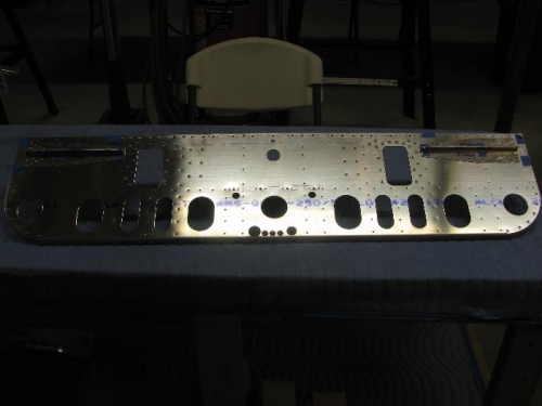

Brief Description:  Fuse MF Ribs/Bot. Skin
Pg. 21-10
Step 9: Fitted Stub Spar Receptacles to the Stub Spars of both wings.
Step 10: Clecoed and riveted the Stub Spar Receptacles and Supports to the F-1203A Bulkhead using the two holes in the center. Final drilled all remaining holes as they were too tight.
Pg. 21-11
Step 2: Riveted the F-1203E-L & R Bulkhead Doublers to both ends of the F-1203A Bulkhead, Stub Spar Receptacles and Supports in the designated holes.
Step 3: Riveted the flanges of the F-1203E-L & R Bulkhead Doublers together. Used small diameter squeezing sets for clearance.
F-1203E Bkhd Doublers
