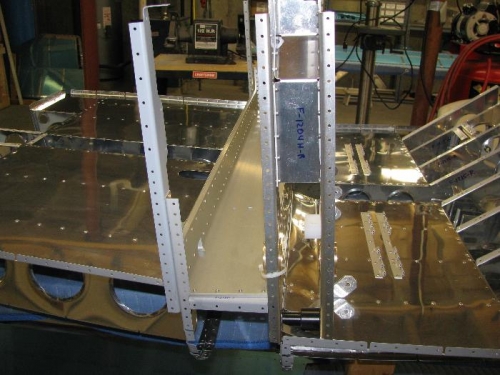

Step 1: Riveted the Fwd Bulkhead Side Assemblies to the Seat Floor Assemblies.
Step 2: Riveted a Bulkhead Cap to the L Bulkhead Side Assys.
Step 3: Inserted AL bushing into F-1204M Roller and installed between L Fwd and Aft Side Assys using an AN3-24A bolt and AN960-10 Washer.
Step 4: Riveted a Bulkhead Cap to the R Bulkhead Side Assys.
Step 5: Inserted AL bushing into F-1204M Roller and installed between R Fwd and Aft Side Assys using an AN3-24A bolt and AN 960-10 Washer.
Torqued both bolts to 25 inch-lbs.

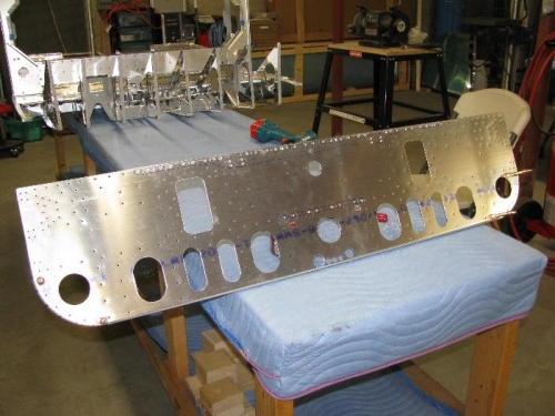

Step 6: Machine countersunk all #40 nutplate rivet holes and six #30 on the F-1203A Bulkhead. #30 holes countersunk 120 degrees.
Step 7: Drilled three 1/8 holes to 7/16, one 1/8 hole to 3/4 and removed material from 7/8 hole.
Step 8: Riveted L & R F-1203B Bulkhead Flanges to the aft side of the F-1203A Bulkhead.
Bulkhead Caps
Bulkhead Caps
F-1203A Bulkhead
F-1203A Bulkhead
