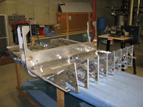

Date:  7-7-2009
Number of Hours:  4.00
Brief Description:  Fuse MF Ribs/Bot. Skin
Pg. 21-03
Step 5: Riveted the Baggage Floor to the F-1206A Bulkhead and F-1206-L & R Baggage Ribs.
Step 6: Dimpled ten nutplates and riveted them to the flanges of the F-1206A Bulkhead, Baggage Ribs and Baggage Floors.
Pg. 21-08
Step 5: Riveted the L & R Seat Floor Assys to the Center Section.
Deburred two F-1204H Bulkhead Caps. Primed the Bulkhead Cap Flanges and the Bot. Flg of the Center Section Bulkhead.
Baggage Floors
Baggage Floors
Seat Floors
Seat Floors
