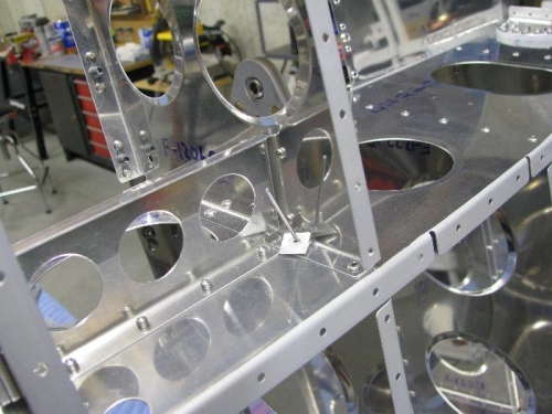

Step 4: Riveted L & R Baggage Ribs to the Center Section Aft Bulkhead and L & R Baggage Floors with manufactured heads on the bulkhead.
Step 5: Dimpled 12 nutplates and riveted them to the Baggage Ribs and Baggage floors.
Pg. 21-03

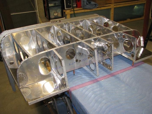

Step 1: Riveted the F-1206A Bulkhead to the Fwd L & R Baggage Ribs.
Step 2: Riuveted the F-1206A Bulkhead to the F-1206G L & R Baggage Ribs and F-1221 L & R Baggage Ribs.
Step 3: Dimpled holes in the top flg of the F-1206H L & R Baggage Ribs.
Step 4: Riveted the F-1206H L & R Baggage Ribs to the F-1206 Bulkhead.
Baggage Ribs -1
Baggage Ribs -1

Baggage Ribs - 2
Baggage Ribs - 2
