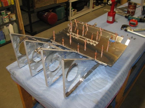

Deburred F-1215-L&R Seat Ribs (Rework) for outbd L&R Seat Rib Assys.
Pg. 21-04 (Rework)
Step 7: Removed verticle strips from ribs.
Step 8: Clecoed the Seat Ribs, Seat Belt Attach Lugs and Supports together.
Step 9: Final drilled #30 the common holes and riveted the parts together.
Pg. 21-07
Step 6: Riveted the Seat Floor to the Lt. Seat Rib Assy. and Flaperon Mixer Bracket/Seat Rib Assy.
Step 7: Dimpled and riveted the nutplates to the Flaperon Mixer Bracket / Seat Rib Assy. and to the Seat floor.
Step 8: Riveted the Lt. Seat Floor Support to the bottom of the Seat Floor.
Step 9: Install the SB-625-8 Snap Bushings into the ribs.

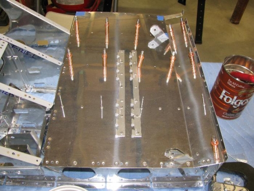

Pg. 21-8
Step 1: Riveted the Seat Floor to the Rt. Seat Rib Assy. and Pully Bracket Assy. / Seat Rib Assy.
Step 2: Dimpled and riveted the nutplates to the Pully Bracket Assy / Seat Rib Assy.
Step 3: Riveted the Rt. Seat Floor Support to the bottom of the Seat Floor.
Step 4: Installed the SB-625-8 Snap Bushings into the ribs.
Lt. Seat Floor
Lt. Seat Floor
Rt. Seat Floor
Rt. Seat Floor
