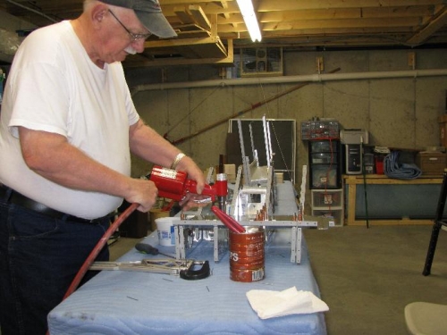

Step 12: Riveted the remaining Flaperon Stop and Flaperon Mixer Assy. to the Rt. Seat Rib Assy.
Step 13: Riveted the Rt. Seat Rib with Nutplates to the Flaperon Mixer Arm Assy.
Deburred and primed two each Crotch Strap brackets.

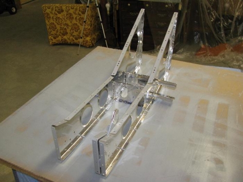

Pg. 21-06
Step 1: Dimpled the nutplate holes for two F-1276A Crotch Strap Brackets and machine countersunk the nutplate holes for two F-1276B Crotch Strap Brackets.
Step 2: Dimpled the nutplates, then riveted the nutplates in place for the four brackets.
Step 3: Dimpled the #30 hole in slope of the remaining Rt Seat Rib.
Step 4: Riveted an A & B Crotch Strap Bracket to Flaperon Mixer Bracket/Seat Rib Assy. and the remaining Rt. Seat Rib.
Step 5: Dimpled the four #30 holes in the sloped flange of the remaining Lt. Seat Rib.
Step 6: Riveted the remaining A & B Crotch Strap Bracket to the Pulley Bracket/Seat Rib Assy. and Lt. Seat Rib.
Crotch Strap Assy
Crotch Strap Assy
