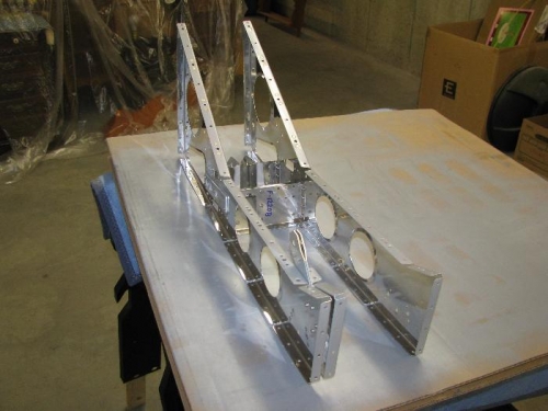

Brief Description:  Fuse MF/Bot. Skin
Pg. 21-05
Step 2: Dimpled the hole in the aft, sloped flange of the rib assys.
Step 3: Dimpled and riveted four K-1000 nutplates for both rib assy. sloping flanges.
Step 4: Dimpled the #30 holes in both Seat Rib Assys.
Step 5: Final Drilled #19 the screw holes in the remaining seat ribs.
Step 6: Dimpled the nutplates of two of the four remaining set ribs.
Step 7: Dimpled the nutplates and holes at the aft end of the Lt. Seat Rib Assy.
Step 8: Machine countersunk the two holes in both flaperon stops.
Step 9: Riveted one Flaperon Stop and Pully Bracket Assy. to the Lt. Seat Rib Assy.
Step 10: Riveted the lt. seat rib with nutplates to the Pully Bracket.
Step 11: Dimpled the nutplates and holes in the aft end of the Rt. Seatbelt Assy. Then riveted the nutplates.
Pully Bracket Assy.
Pully Bracket Assy.
