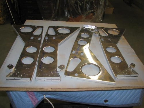

Deburred Seat Ribs.
Pg. 21-04
Step 7: There was no vertical strips in my seat rib holes.
Step 8: Clecoed together two Rt. & Lt. Seat Rib Assys.
Step 9: Final drilled #30 the eight holes in each assy. After deburring the holes, riveted together the assys.
Pg. 21-05
Step 1: Final drilled #19 the nine screw holes in each of the two ribs indicated.
Seat Rib Assys.
Seat Rib Assys.
