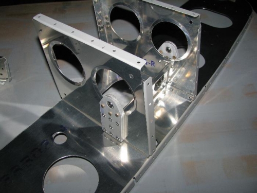

Step 8: Riveted the Rear Spar Receptical Supports and Recepticals to the F-1206A Bulkhead.
Step 10: Dimpled the holes for the center nutplates on the top flange of the F-1206A Bulkhead.
Step 11: Dimpled the nutplates for the corresponding locations.
Step 12: Dimpled the nutplates and corresponding holes for the F-1206G-L&R Baggage Ribs.
Step 13: Riveted the nutplates fo these Baggage Ribs.
Step 14: Riveted together the Bearing Bracket Assemblies using flush rivets after machine countersinking the holes on one side of each bracket.
Pg. 21-3
Step 7: Riveted the Bearing Bracket Brace to the F-1206A Bulkhead.
Step 8: Riveted the Bearing Bracket Brace to the F-1206G-L&R Baggage Ribs and Bearing Bracket Assys.
Step 9: Separated the Pully Brackets and Deburred.
Step 10: Riveted Pully Brackets to the Fwd and Aft Intercostals.

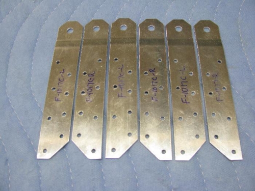

Pg. 21-4
Step 1: Separated the Flaperon Mixer Arm and deburred.
Step 6: Separated the four sets of Seat Belt Attach Lugs and Seat Belt Attach Lug Supports. Deburred the parts.
