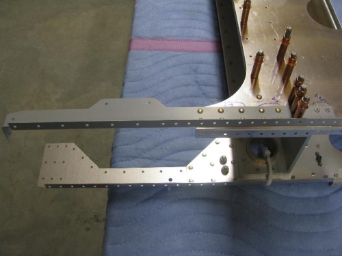

Brief Description:  Ctr Sec Blkhd Pg. 20-3, 20-4
Pg. 20-3
Step 4: Machine countersunk the designated holes in Center Section Assy. Dimpled the corresponding holes in the Center Section Aft Bulkhead.
Step 7: Riveted the L&R Skin Attach Flanges to the Center Section Assy.
Pg. 20-4
Step 1: Attached the Center Section Aft Bulkhead and the L&R Aft Side Bulkheads to the Center Section Assy.
Skin Attach Flange
Skin Attach Flange
Aft Side Bulkhead
Aft Side Bulkhead
