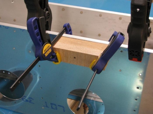

Morning was taken up with delivery of my hanger door.
Step 2: Released the pressure of the clamps briefly, then proceeded to match drill #30 the seventy one holes identified on the drawing. Used a drill guide as we were drilling through thick material. Started in the center and proceeded outward. Two additional holes were drilled #11. Holes were clecoed as I proceeded.
Step 5: Separated the F-1204P-L&R Skin Attach Flanges.
Step 6: Separated the F-1204T-L&R Skin Stiffeners.
Deburred and primed the F-1204P-L&R, F-1204T-L&R, and F-1204F-L&R.
Drill Guide
Drill Guide
Drill Guide Modified
