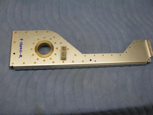

Step 2: Final drilled the holes in the Rt. Fwd Bulkhead Side Assy. Installed the Retainer Block and final torqued.
Step 3: Final drilled the Center Section Assy and installed the Retainer Block and final torqued.

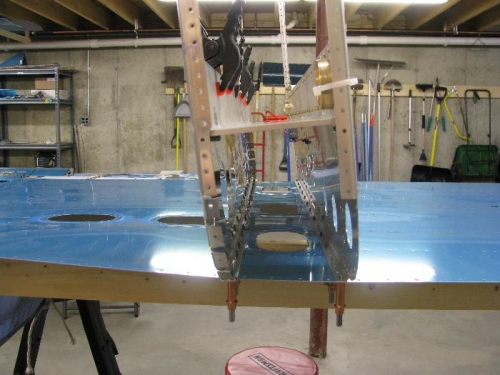

Step 4: Inserted two AN4 bolts in the 1/4" holes of the Center Section Aft Bulkhead to support Center Section Channel. Clamped the Center Section Assy to the Aft Center Section Bulkhead using five spring clamps.

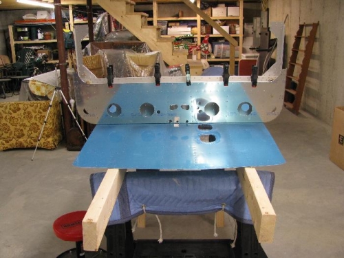

Step 1: Placed the Bottom Skin on top of two 2X4's which were placed across two saw horses. The clamped bulkhead assy were clecoed to the Bottom Skin.
Center Section 1
Center Section 1
Center Section 2
Center Section 2
Retainer Block
Retainer Block
