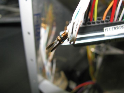

Brief Description:  Fuselage Wiring Harness
During pulling the P-30 Trim Wire harness from the Tail Cone to the Panel Base three pins were broken off. New pins and a crimper were purchased. The remaining pins were removed and all the pins replaced.
Pg. 31-14
Step 1: The WH-RV-12-TUNNEL harness was shipped without the d-sub backshell installed. Inserted the MUSIC harness, P-30 Trim Wire harness and the P & CP Push to Talk harnesses through the heat srink and plugged the pins into the 37-pin D-Sub male connector at the locations indicated in Figure 2.
P-30 Pins Broken Off
