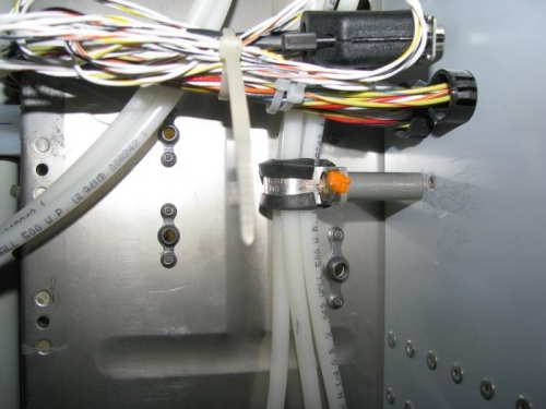

Step 3: Secured the L & R Reservoir Brake Lines and Cross-Over Brake Lines to the bottom of the Base Panel using the AL .197 X .313 X .968 stand-off, cushion clamp and hardware provided. This keeps the brake lines from chaffing on bolting which penetrates the Firewall.
Brake Line Stand-Off
