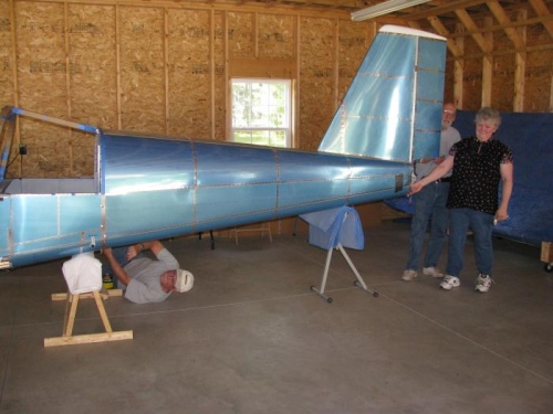

Step 1: Supported the Fuselage and Tailcone Assembly on padded saw horses and an adjustable stand. Dave, Russ and I mated the Tailcone to the Fuselage, overlapping skins per the plans. Then randomly clecoed in place.

Mating the Tailcone to the Fuselage
