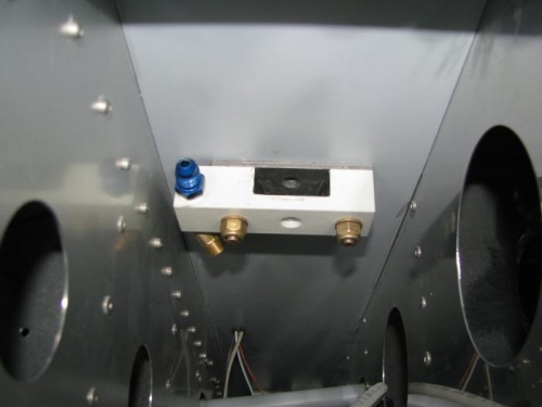

Step 1: Applied thread sealant to the fluid fittings and installed them into the Inboard Main Gear Attach Brackets. Set the angled fitting at the prscribed 45 degrees.
Step 2: Coated the Inboard and Outboard Wear Plates with a thin layer of Aeroshell 22 grease. Install the Inboard Main Gear Attach Brackets, Inboard Wear Plates and Doubler Plates, leaving the center bolt out and the outside bolts loose. Installed the Outboard Main Gear Attach Brackets and Outboard Wear Plates, leaving the bolts loose.
Left Inboard Main Gear Attach Bracket

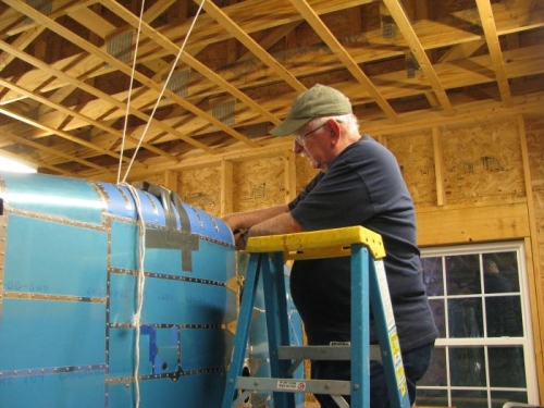

Installing Main Gear Brackets
