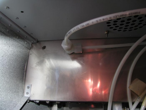

Step 2: Secured the Reservoir Brake lines to the Brake Reservoir by pushing the lines into the loosened fittings until they bottomed out then tightening the nuts. The nylon tee was previously attached to the Reservoir through the Firewall as it had to be sealed with tank sealant. Thread sealant was used on the tee threads.
Held off on step 3 until I recieve new hardware to perform rev. 1.
Relocated the crossover brake lines fwd of the wire run so they will be captured by the cushion clamp. Torqued all brake line fittings at the Rudder Pedals
Brake lines Fwd of the Wire Run
Brake Reservoir Lines
