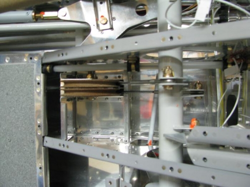

Attempted to Install the Fwd Stabilator cables in the Fuselage. Found they were connected backwards and wrapped around the Left Rudder Cable. Pulled out the Pulleys and disconnected the Stabilator Cables from the Control Column. Pulled them back and straightened them out.
Pg. 32-14
Step 1: Routed the Aft Stabilator Cables forward through the holes in F-1207B and F-1206A Bulkheads. Verified the cable from the top stabilator horn passed through the upper hole.
Step 2: Routed the Fwd Stabilator Cables aft through the holes in the F-1204A & D Bulkheads. Verified the cable from the right pulley passed through the upper hole.
Step 3: Reached through the access holes in the bottom of the fuselage and connected the Fwd and Aft Stabilator Control Cables.
