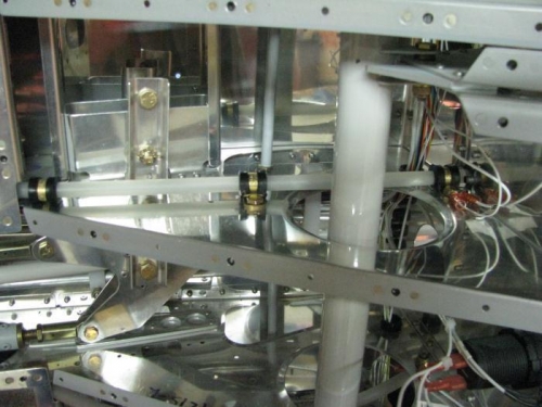

Step 1: Routed the spade end of the Left Rudder Cable along with the 11-1/2" plastic sleeve thyrough the SB750-10 snap bushings in the F-1207B, F-1206A, F-1204D & A bulkheads. Left the sleeve at that location and continued to route the cable through the 9/16" hole in F-1203A and the snap bushing in F-1202F.
Step 2: Secured the plastic sleeve with three MS21919DG6 Cushion Clamps. The sleeve extended through the 9/16" hole by 3/8".
Left Side Rudder Cable Routing
