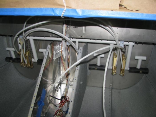

Step 8: With assistance from Dave, we removed the the lower halves of the Rudder Pedal Blocks and slid the Rudder Pedal Assy into position in the Fuselage.
Step 9: Bolted the Rudder Pedal Assy through the Lower & Upper Rudder Pedal Blocks into the Rudder Pedal support Channels.
Pg. 27-05
Step 5: Secured the Brake Lines to the lower elbow of both master cylinders of the Left Rudder Pedals.
Rudder Pedals Installed
