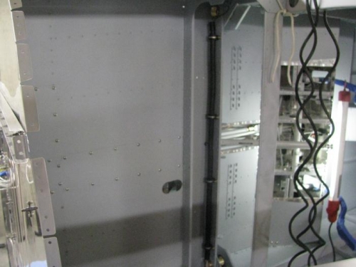

Step 3: Installed the clamps and attached the Wire Run Conduit to the Center Section Assy.

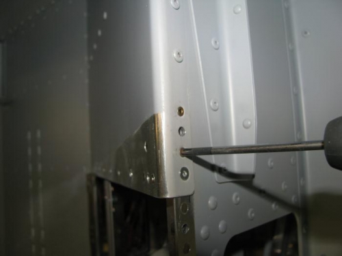

Pg. 21-13
Step 7: Discovered that the nutplates of this step on both sides were only held with one CCR264SS-3-2 rivet. The other rivet was set but did not catch the nutplate. Removed these rivets and using a small phillips screw driver spun the nutplates into position. Secured them with an AN526C832R8 screw, then properly set a new rivet in place. Worked great as access to the back was obstructed by the flight controls, though you could see the back with a mirror.

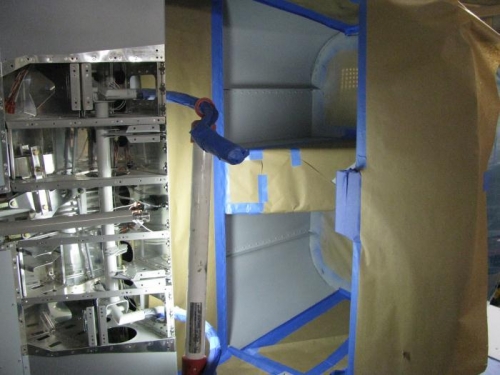

Masked the footwell areas for final scratch resistant paint. Interior trim will be added after certification.
Wire Run Conduit Installed
Technique for Aligning the Nutplates
Masking fo Final Painting the Footwells
