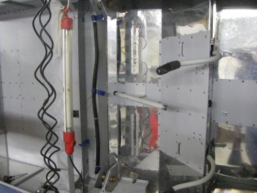

Installed the ES-320559 splice connectors as shown in figure 5 on the left side.

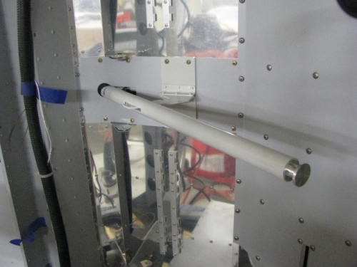

Pg. 33-02
Step 2: Removed the Detent Bracket Assy and slipped the Seat Floor Cover over the Flap Handle. Attached the Seat Floor Cover to the Seat Floor, then screwed the Detent Bracket Assy to the Seat Floor Cover.
Step 5: Removed the VA-104-3 Knob and fastened the Seat Ramp Cover and Step Floor Cover.
Pg. 33-03
Step 5: Installed the the Rudder Pedal Access Covers.
Step 6: Trimmed the MS2166-1N Grommet and installed it on the Tunnel Cover.
Step 7: Installed the Tunnel Cover.

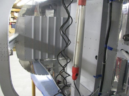

Step 8: Verified the #19 holes were dimpled in the Baggage Cover.
Step 9: Installed the Baggage Floor Cover, Baggage Bulkhead Corregation and Baggage Cover.
These covers were installed to provide for painting the interior and will be removed again for electrical and flight control work.
Forward Covers Installed
Aft Covers Installed
Detent Bracket Assy
Detent Bracket Assy
