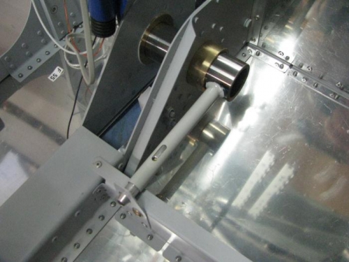

Step 4: Used a multimeter set for checking continuity to test the Spar Pin Reed Switches in accordance with the Change Notice issued on 3-12-10. I had problems with the switches showing continuity with the Pin Stoppers both engaged and disengaged using the light technique. With the multimeter I only had to adjust the right switch outboard 1/32" to get proper operation. The left side worked without any adjustment. Thanks to Van's Support for working on and solving the problem.

Step 5: Added Loctite 242 to the screw threads on the pin stoppers and inserted the screws.

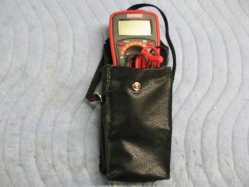

Craftsman Multimeter. Carrying Case Made by My Wife.

Pin Stopper Inserted and Reed Switch functioning
