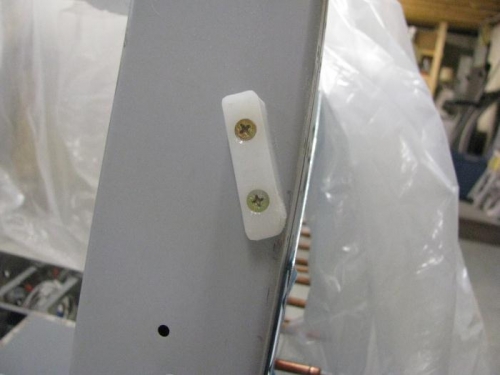

Step 6: Lowered the Canopy to verify there were not conflicts between the side screws and the lower outboard corners of the Guide Blocks. There was contact, so the were chamfered. There is only slight contact now and I may removed additional material.
Sanded the micro previously applied inside the Canopy Arms and added still more micro. This is not adding much weight as most of the previous micro gets removed when sanded.
Chamfered Guide Block
