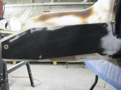

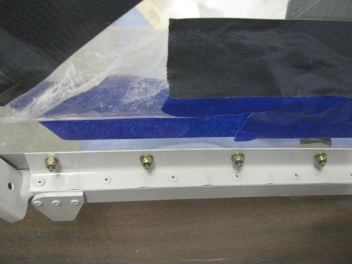

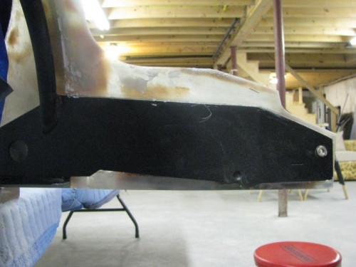

Cleaned up the resin drips and runs inside the Canopy Arms. Added micro-balloon dry mix in the low areas inside the arms. Drilled out the holes in the Skirt, then installed screws, washers and nuts. Also added washers that Van's sent to replace the extra washers I used in the Fuel Tank per the incorrect instructions. There were several screws on the Canopy that were lacking washers.
Micro Added to Fill Low Spots - Right Side. Light Areas On The Frame Are Where Resin Was Cleaned Off
Micro Added to Fill Low Spot - Left Side
Washers Added to Screws and Nuts
