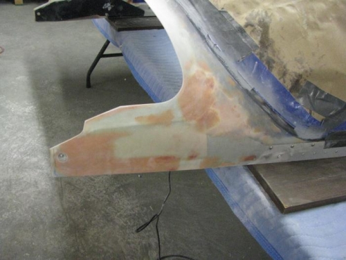

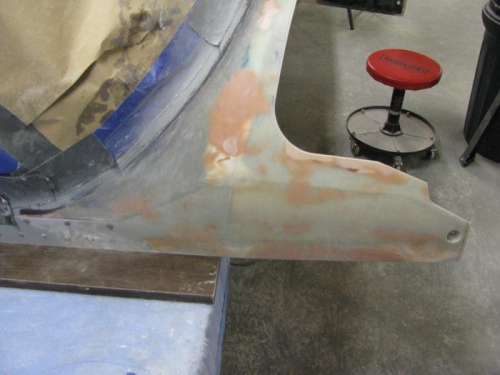

Step 2: Trimmed the edges that overlap the Fuselage Side Skin. Used a straight edge to verify the trimmed edge was parallel with the bottom edge of the Skirt.
Step 3: Taped the CANOPY LAY-UP TRIM TEMPLATE to the Canopy and the trim line. The cut the glass to 1/8" of the line with a Dremel tool and a cut off disk. Rough sanded then final sanded to the line.

Trimmed Left Side
Trimmed Left Side
Trimmed Right Side
Trimmed Right Side
