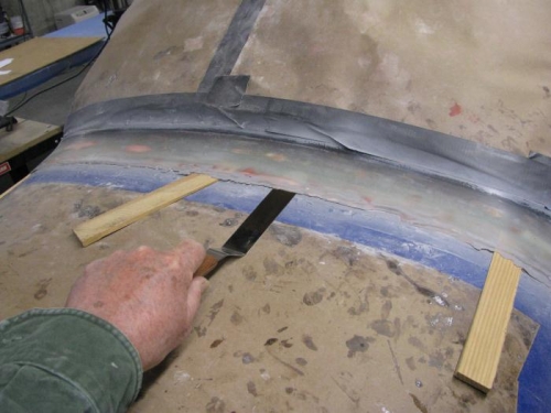

Step 1: Removed the Canopy with much difficulty. Dripping resin had bonded to the Fuse in a few spots. Used a Wilfork Icing knife to loosen the fiberglass at the edges.

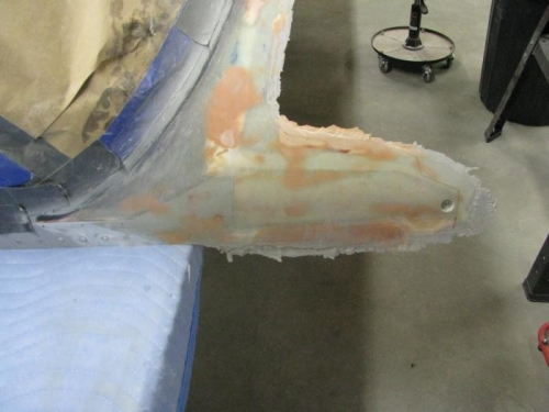

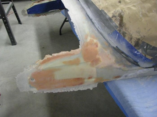

Step 2: Trimmed the edges that overlap the Fuselage Side Skin using a straight edge to line up the edge with the bottom of the Skirt.
Releasing the Glass from the Fuselage
Pretrimmed Canopy-Left Side
Pretrimmed Canopy-Right Side
