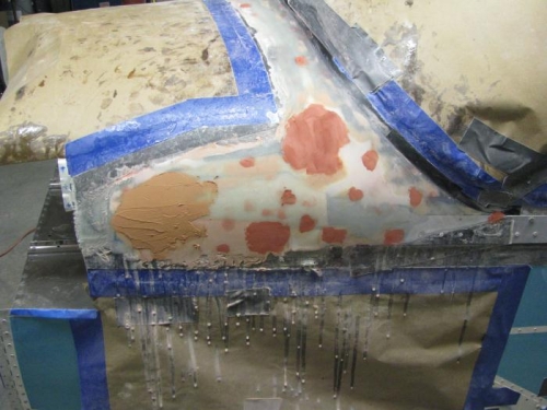

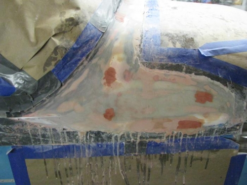

Step 5: Sanded the Bondo and Putty areas with 320 grit paper. After sanding I found more low spots and pin holes. Built up these areas with Bondo and spotting putty. Some were in the previously applied Bondo.
More Bondo and Putty Left Side
More Putty Right Side
