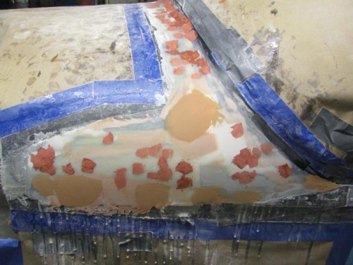

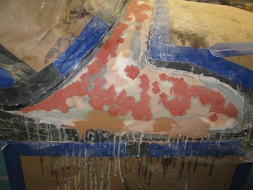

Step 5: Sanded Bondo with 220 grit, then touched up more low spots with Bondo and pin holes with spotting putty. Is there any end to this process?

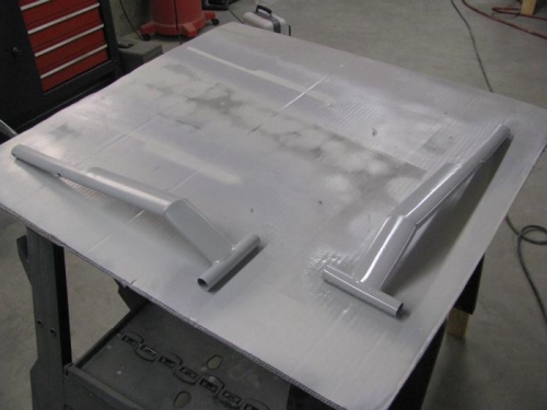

Primed aircraft boarding steps with Marhyde to avoid rusting.
Spotted More Low Spots and Pin Holes Left Side
Spotted More Low Spots and Pin Holes Right Side.
Boading Steps Primed
