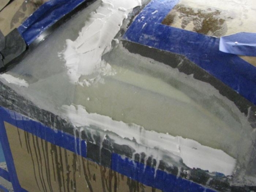

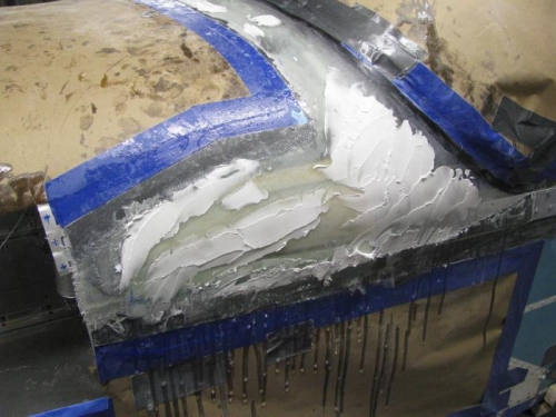

Step 5: Continued by sanding the resin coat previously applied with 100 grit then 150 grit sand paper. Mixed a dry batch of micro which was like cookie dough. Applied it to the low areas on the left and right sides and a few spots across the top. I'll let this cure over the weekend.
Micro Applied to Left Side
Micro Applied to Right Side
