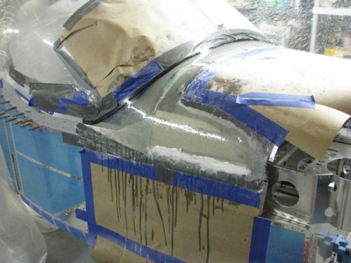

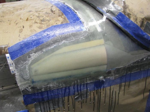

Step 5: Continued by brushing on a heavy coat of resin over the layups. Added some micro to low spots on the right side where repair was made. This did no stay put, as the mix was too wet and it ran some and will need additional fill.
First Heavy Coat of Resin
Micro Added to Repair Area
