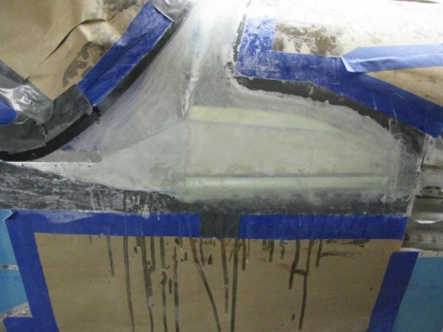

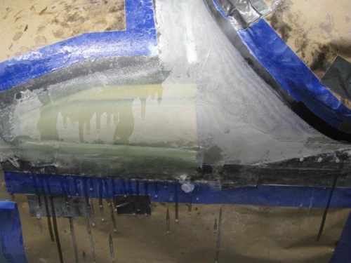

Repaired low areas along the top and bottom edges on both sides of the canopy arms and the pointy aft end of the lay ups between the Canopy and Skirt by scuffing with 60 grit sand paper and adding small wet lay ups. Then let these cure over night.
Added Layups Top, Bottom and Aft on Left Side
Added Layups on Bottom and Aft Areas
