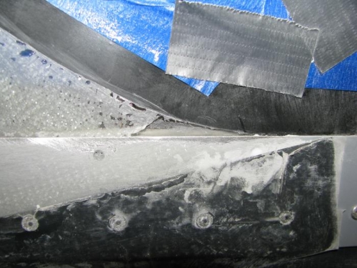

Step 5: Removed the second layer of electrical tape and sanded with 150 grit until the aft edge was down to the first layer. Discovered I have some areas at the aft pointed location and bottom edges on both side that do not have enough coverage. Will have to contact Van's for directions.
Missing glass
Missing glass
Short Glass Coverage
