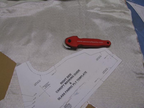

Step 4: Cut the ten plys of #1 through #5 from the 9 oz. / sq. yd. plain weave E-glass fabric using a rotary cutter. Piled in two sets of five plys.

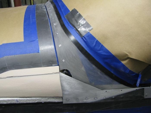

Step 5: Sanded the Canopy and Canopy Skirt with 80 grit sand paper until there was no gloss anywhere. Blew away the dust and debris with compressed air.
Cutting Fabric
Cutting Fabric
Rotary Cutter
Rotary Cutter
Canopy & Skirt Sanded
