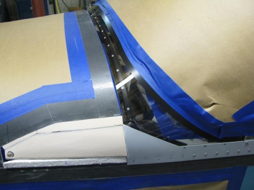

Date:  3-12-2010
Number of Hours:  3.50
Brief Description:  Canopy Installation
Pg. 34-14
Step 1: Used along commercial sanding block with 80 grit sand paper to form the foam blocks to the contour of the Fuse.
Step 2: Taped the templates onto the Canopy and Fuse.
Step 3: Placed a strip of electrical tape along the edge of the templates. Bridged the gap between the tempates by maintaining a constant distance from the aft edge of the Upper Fuse Skin. Removed the templates and placed a second layer of tape on top of the first. Masked off the Canopy aft of the electrical tape.
Foam Contoured
Foam Contoured
Electrical Tape Applied
