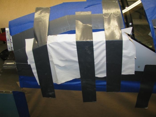

Step 4: Mixed a two pump batch of epoxy and flox. Applied a 1/16" layer to the inside surface of the foam blocks. Then put them into position and secured with duct tape. Used West Systems 105 resin and 206 Hardener at 70 F. The epoxy was very slow setting up, but was rock hard after curing over night.

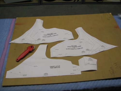

Step 2: Cut out the CANOPY MASKING GUIDE & GLASS FABRIC PLY TEMPLATES.
Foam Blocks Secured
Foam Blocks Secured
Templates Cut Out
Templates Cut Out
