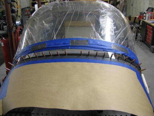

Step 4: Took the Canopy off and measured, marked and drilled the upper #30 holes in the Roll Bar Frame. Tapped the holes 8-32 on both sides. Attached the Guide blocks to the Canopy Frame.
Step 5: Rotated the Guide Blocks until the lower corner was tangent with the outer edge of the Roll Bar. Marked, Drilled #30 and tapped the lower holes into The Roll Bar. Removed to clear the chips and reinstalled.
Pg. 34-09
Step 2: Clecoed the Canopy to the Canopy Frame along the front bow.

Canopy Front Bow Clecoed
