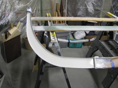

Touched up bad paint job.

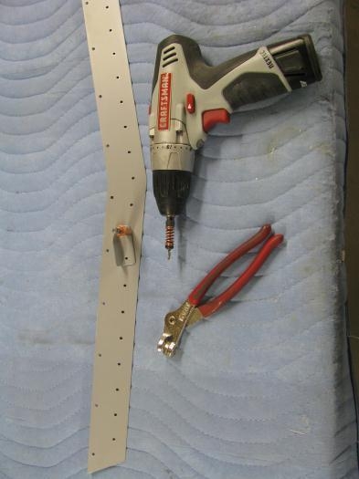

Step 1: Clecoed the previously fabricated C-1210 Lift Handles to the Canopy Skirts. Aligned the Lift Handle and match-drilled the second hole in the Lift Handle using the hole in the Canopy Skirt as a guide.

Repaired Paint Job
Repaired Paint Job
Installing Lift Handles
