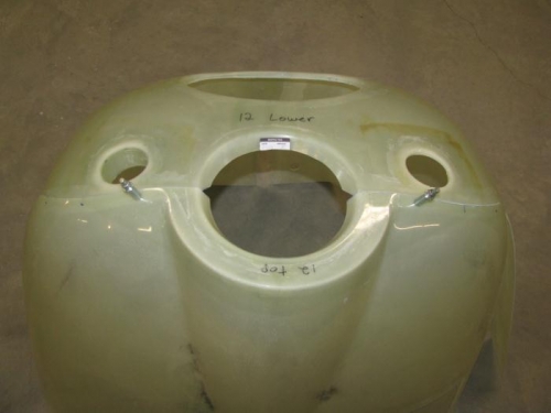

Step 1: Trimmed the Top and Bottom Cowls to within 1/8" of the scribe line using a Dremel tool with a reinforced cut-off wheel. Sanded to the scribe line with a vibrating sander and 60 grit sand paper.
Step 2: Sanded away excess resin from inside surfaces of the Top Cowl and outside corners of the flange on the Bottom Cowl.
Step 3: Sanded the flange of the Bottom Cowl to 5/8".
Step 4: Clamped the cowls together and marked the locations of the three holes on each side of the Top Cowl. Drilled #40 the inboard holes on each side.

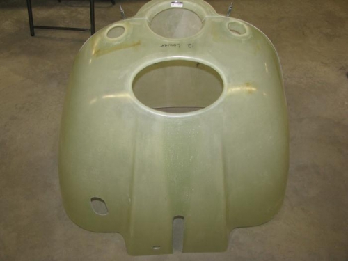

Step 5: Cut then sanded the slot in the Bottom Cowl.
Step 6: Used a Unibit to start the holes for the Gascolator and Exhaust Pipe. Finished the holes with a file and a Dremel tool.
Step 7: Cut the excess material from the Bottom Cowl air inlet with the Dremel and sanded to the scribe line.
Bottom Cowl Holesw Finished
Font Holes Marked and Drilled
