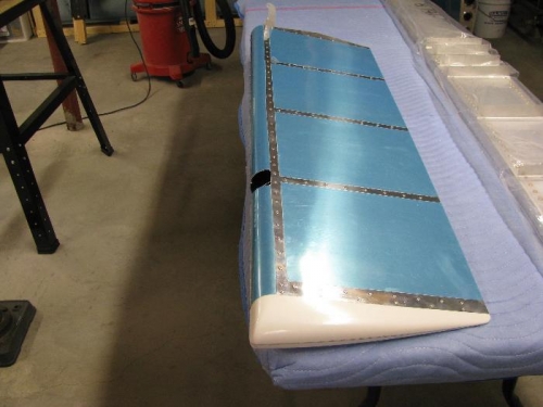

Brief Description:  Fairings Pg. 12-2 Stp. 5-6, Pg. 12-3 Stp. 1-4, Pg.
Pg. 12-2
Step 5: Removed excess material from Rudder Tip Fairing to achieve a flush fit with top of Rudder Skin.
Step 6: Match-drilled the #30 hole from the skin into the fairing.
Pg. 12-3
Step 1: Removed excess material from V-Stab. Tip Fairing to achieve a flush fit with top of V-Stab Skin.
Step 2: Match-drilled #30 holes from the skin into the fairing.
Step 3: Made a smooth transition at the aft end of the Tip Fairing with the aft edge of the Main Skin.
Step 4: Trimmed the aft end of the Tip Fairing.
Will perform fit with Rudder Tip Fairing later.
Pg. 12-4
Step 3: Riveted Rudder Tip Fairing to Rudder Assembly.
Rudder Tip Fairing
Rudder Tip Fairing
V-Stab. Tip Fairing
V-Stab. Tip Fairing
