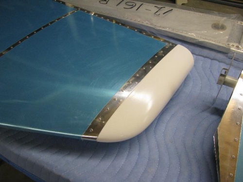

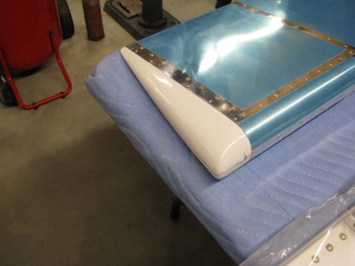

Step 1: Used a file to ensure step was was square on the V. Stab and Rudder Fairings.
Step 2: Trimmed the extra material from the Rudder Tip Fairing using a belt sander and a file.
Step 3: Trimmed the extra material from the V-Stab. Tip Fairing in the same manner.
Step 4: Trimmed the V-Stab. Tip Fairing in the aft area as shown.
V-Stab Tip Fairing
V-Stab Tip Fairing
Rudder Tip Fairing
Rudder Tip Fairing
