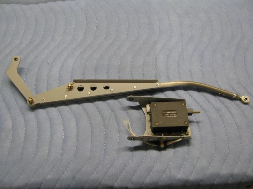

Step 4: Clecoed the Doublers, Pitch/Trim Servo and Tray together.
Step 5: Match-drilled and final-drilled the #27 holes in the Doublers, Pitch/Trim Servo and the Tray.
Step 6: Used Hardware to attach Pitch/Trim Servo to Tray.
Step 8: Deburred and primed the Link.
Step 9: Installed Polymer Bushing into link.
Step 10: Filed the bushing to size.
Step 11: Installed snap bushing and routed wires through the bushing.
Step 14: Installed the cushioned clamp to support the wires
Pitch/Trim Servo Assy.
