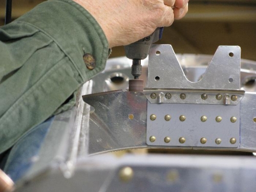

Step 4: Dimpled nutplate attach holes. Relieved the ends of the angle to avoid deforming the Top Skin.

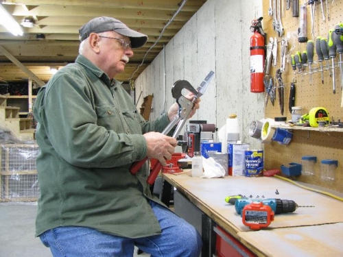

Step 5: Riveted the nut plates to the Fwd Skin Rib.

Relieving Angle
Relieving Angle
Riveting nutplates
Riveting nutplates
