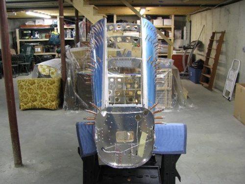

Brief Description:  Tail Cone Pg. 10-9, Stp. 2-9
Deburred and primed Lt. & Rt. Upper Skins.
Step 2: Clecoed Upper Skins to frames.
Step 3: Clecoed Snap Bushing Brackets to the skins.
Step 4: Match-drilled the #30 holes in the Snap Bushings and deburred.
Step 5: Riveted the Snap Bushings to the skins.
Step 6: Installed the Snap Bushing into the brackets.
Step 7: Routed the string for the rudder control through the Snap Bushing and Aft Bulkhead and secured at fwd end.
Step 8: Masked the holes at the fwd end of the Tail Cone
Step 9: Riveted the Upper Skins to the structure including the Hinge Brackets and excluding the Upper Frames.
Upper Skins
Upper Skins
