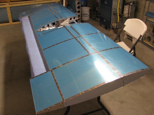

Step 3: Riveted the Aft Hinges to the Main Skin.
Step 4: Riveted Aft Ribs to the Main Skins.
Step 5: Riveted the remaining holes in the aft flanges of the Main Skin.

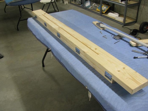

Step 7: Pinched the edges of the Aft Skins using my 2X6 Brake. Used a 1/8" dowel to maintain a consistant radius at the aft edge of the skins.
Step 8: Match-drilled the #30 holes from the Aft Skins into the Aft Ribs.
Step 9: Riveted the Aft Skins to the Aft Ribs. Body of Stabilator is complete.
Skin Edge Brake
Skin Edge Brake
Finished Stabilator
Finished Stabilator
