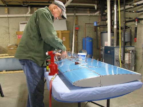

Brief Description:  H. Stab. Pg. 9-8, Stps. 1-6
Step 1: Marked Left and right skins.
Step 2: Clecoed hinges inside Main Skins.
Step 3: Match-drilled The #30 holes in the hinges at the masking tape locations and at the inboard ends. Removede the hinges for deburring.
Step 4: Clecoed the Main Skins to the Stabilator Skeleton.
Step 5: Riveted the Main Skins to the Stabilator Sleleton Assy.
Step 6: Riveted the remaining holes on the Skeleton.
