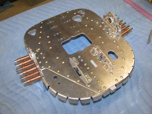

Brief Description:  Tail Cone Pg. 10-4 Rev. 1 Stp. 10-14
Step 10: Riveted the Nutplates to the Bulkhead Assy.
Step 11: Clecoed the Hinge Brackets and Flange Bearings together.
Step 12: Final-drilled the #30 holes in the Hinge Brackets and Bearings.
Step 13: Riveted the Hinge Brackets, Bearings and Fuse. Assy. together.
Step 14: Inserted SB437-4 Bushing into the Bulkhead Assy. after drilling hole out to 7/16" with a Unibit.
